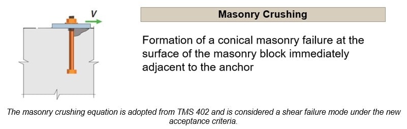

Additionally, for anchors loaded in shear, engineers will need to consider masonry crushing in their post-installed anchor design. The masonry crushing equation has been adopted from the cast-in anchor calculations provided in The Masonry Society (TMS) 402. Masonry is typically a softer material than concrete when exposed to high shear loading and the steel anchor may crush and sink into the masonry block which is now accounted for in the new acceptance criteria.

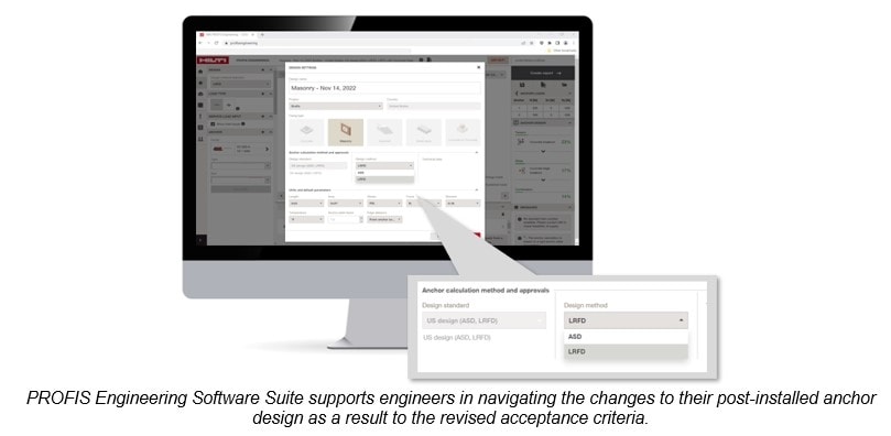

Simplify transition from ASD to LRFD
Hilti’s PROFIS Engineering Suite software is a user-friendly, cloud-based application that helps make designing post-installed anchor connections easier. With the revisions to the Acceptance Criteria, the Anchoring-to-Masonry design module has been updated to support as engineers transition their designs and existing masonry details from ASD to LRFD for post-installed anchors. Engineers may easily transition their design to the guidelines of the new Acceptance Criteria, which will support their compliance with the model building code. The software allows engineers to select multiple masonry types such as grout-filled CMU, ungrouted (hollow) CMU, and clay brick, and it supports the design of Hilti adhesive and mechanical anchors into cracked and uncracked masonry conditions.
Hilti’s existing adhesive and mechanical anchor portfolio for masonry connections has been tested to the new acceptance criteria making anchor selection simple and helping to alleviate concerns about model building code compliance as the industry transitions to the new acceptance criteria.
