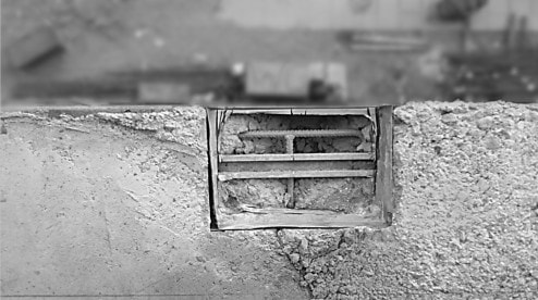

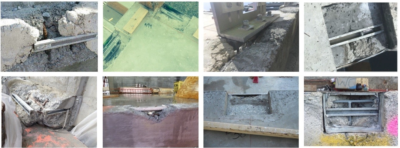

The combination of new construction practices, new technologies, and more sophisticated designs is allowing for the construction of buildings in record times. Spans get longer, columns get smaller, slabs get thinner, and lighter construction materials are used. As a result, the construction process has become more complex and best practices have evolved to solve the disputes of modern business. A common field issue encountered in building construction is the formation of air pockets (entrapped air) in the concrete at the anchorage zone.
Air pocket formation occurs due to improperly or no concrete consolidation. Repairing cured concrete with entrapped air is time-consuming, tedious, and can turn out to be quite expensive. Adopting best practices to ensure proper concrete consolidation is performed at the anchorage zone is one of the most effective ways to minimize field issues due to improper concrete consolidation. A couple of extra seconds at each connection point can pay dividends, avoid additional coordination and additional work to an already complex and fast-track work environment where the project’s schedule leaves room for a minimal margin of error.
Proactivity goes a long way. Implementing best practices that ensure adequate concrete consolidation will ensure the anchorage will perform the way it was designed. During pre-construction meetings, emphasize the importance of adequate concrete consolidation at the anchorage zone, especially if the cast-in anchor is near a confined space or congested zone. Try it out in your next project!
Figure 1: Pictures of Conditions with Improper Concrete Consolidation at the Anchorage Zone.

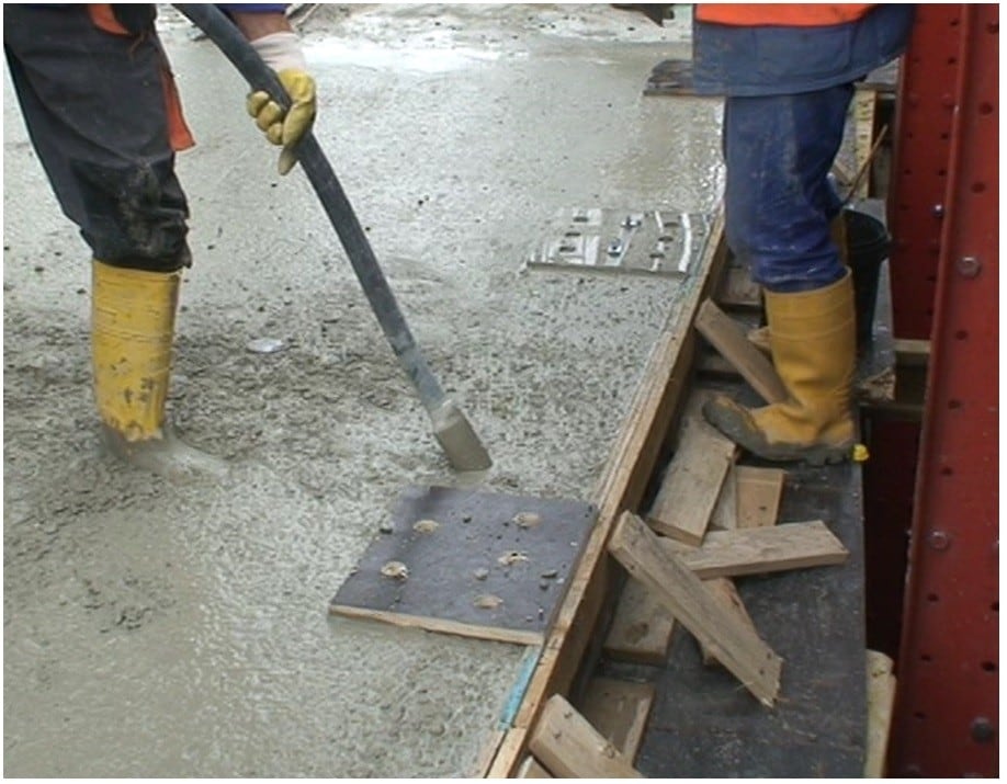

Figure 3: Pouring and Vibrating Concrete at the Edge of the Slab.

Although there are different ways to consolidate the concrete, the most effective way to remove entrapped air is vibration. Vibration consists of subjecting freshly placed concrete to rapid vibratory impulses which liquefy the mortar and significantly reduce the internal friction between aggregate particles (1). Figure 5 illustrates a construction member vibrating the concrete at the anchorage zone using a standard immersion vibrator.
Figure 5: Construction Member Vibrating the Concrete at the Anchorage Zone.

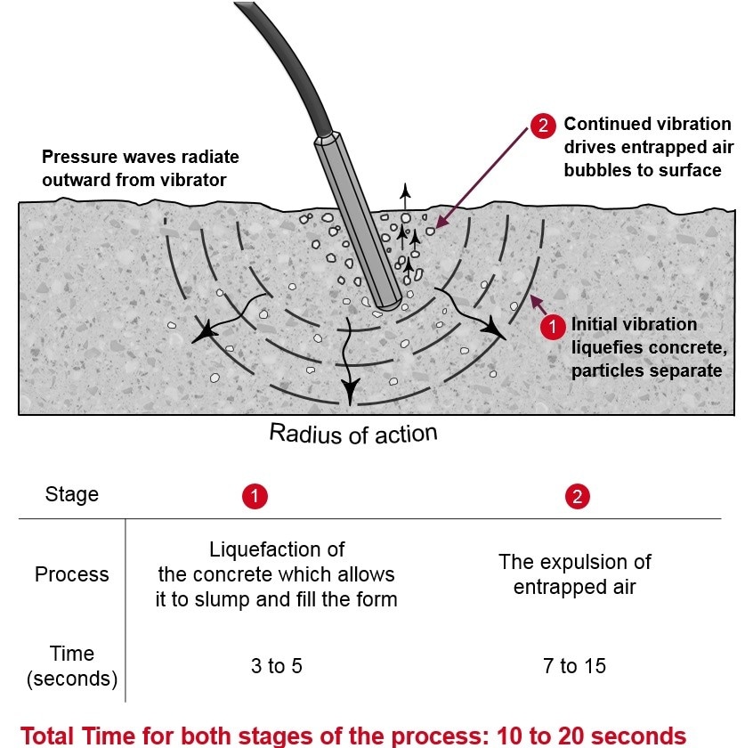

Consolidation via standard immersion vibrators is best described as consisting of two stages—the first comprising subsidence or slumping of the concrete, and the second a de-aeration (removal of entrapped air bubbles). The two stages may occur simultaneously, with the second stage underway near the vibrator before the first stage has been completed at greater distances (2). Figure 6 illustrates the two-stage process to best consolidate concrete.
If in doubt, always err on the side of more vibration.
Figure 6: The Process of Concrete Consolidation (2 & 4).
