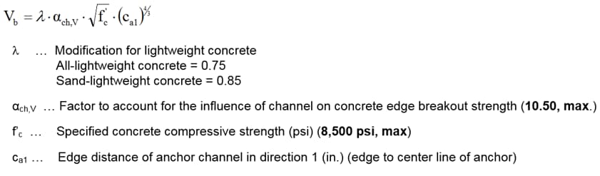

The basic concrete breakout strength of one anchor without the influence of a corner, member thickness or adjacent anchors in unreinforced concrete is determined as follows:
