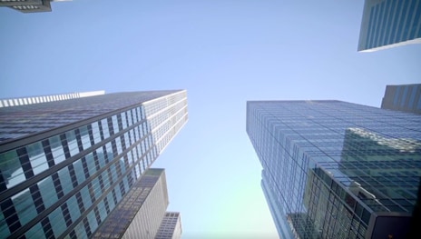

Curtain wall façades in architecture are often the most important aspect from a design standpoint, as they set the tone for the rest of the building. These non-load-bearing exterior walls are an attractive way to enclose buildings while providing energy-efficient and weather-resistant solutions. A curtain wall system hangs off and outside the building like a curtain. Vertical mullions and horizontal transoms are part of a framing system commonly used in curtain walls. These are the vertical and horizontal components that form the structural grid for supporting glass panels or other materials together. This article provides an overview of curtain wall façades and will begin with the main façade styles.

Aluminum curtain walls allow for sleek, modern designs and are commonly used for standard commercial buildings, especially high-rise construction. However, the construction can be a complicated process that requires careful planning.
