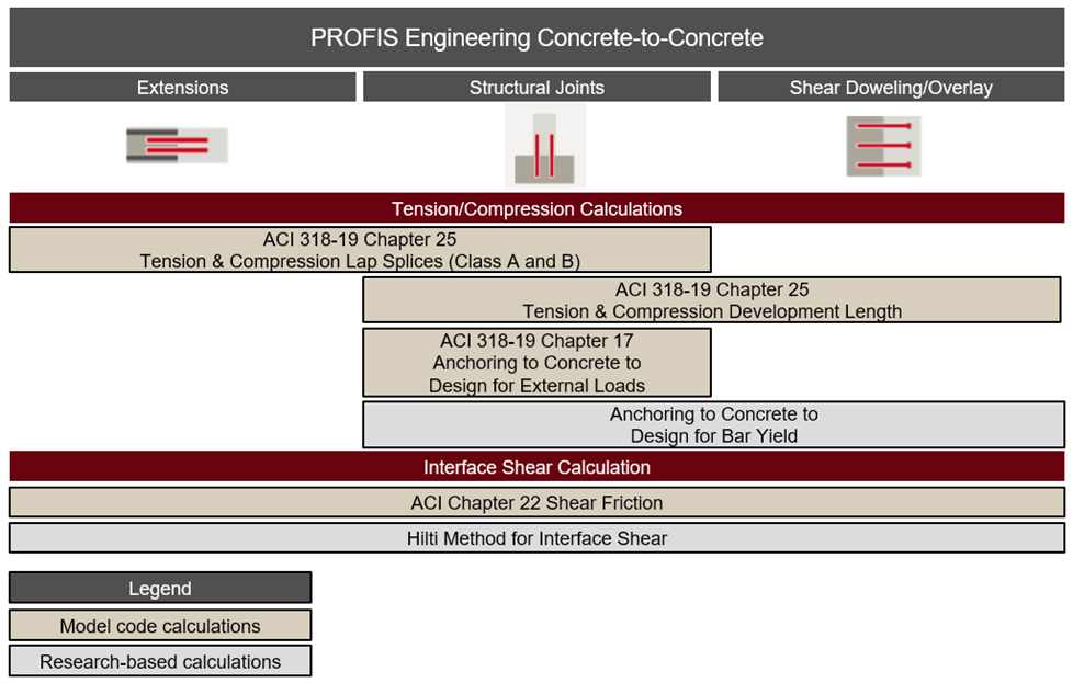

Accelerate post-installed rebar design with PROFIS Engineering’s Concrete to Concrete module. Whether you are designing slab or wall extensions, structural joints, or concrete overlays, this module supports a wide range of design methods per ACI 318-19 and research-based methods including:
  • Development length
  • Lap splices
  • Anchoring to concrete
  • Shear fiction
  • Anchoring to concrete to design for bar yield
  • Hilti Method for Interface Shear

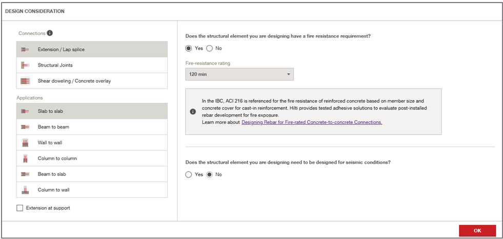

This is the first dialog box after starting a design
This is the first dialog box after starting a design in the Concrete to concrete module.
Step 1: Select Connection Type
Extensions/Lap Splice
  • Uses lap splice design method for embedment depth
Learn more: Extension Design using ACI 318-19 Provisions for Post-installed Reinforcing Bar
Structural Joints
  • Supports multiple design method options and any combination of moment, tension, and shear loads.
Learn more: Structural Joint Design using ACI 381-19 Provisions for Post-installed Reinforcing Bar
Shear doweling/Concrete overlay
  • Designed for shear loads only
  • Offers ACI shear friction or Hilti’s research-based Interface Shear Method
Learn more:
Shear friction using ACI 318-19 Provisions for Post-installed Reinforcing Bar Design
Shear Friction Design using ACI 318-19 Anchoring-to-Concrete Provisions for Post-installed Reinforcing Bar Design

PROFIS Engineering supports design for static, seismic, and fire load types. When starting a new design, the initial dialog asks whether the structural element should be evaluated for fire exposure and/or seismic loads. If selected, the module automatically populates the load table with the chosen load types, streamlining the design process.

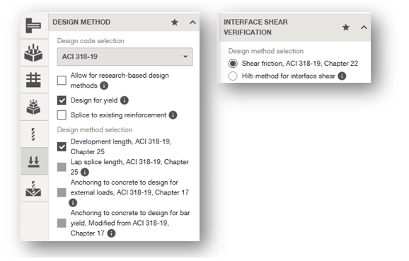

Step 6: Select and Review Design Method Options
Step 3: Select Load Type   Step 4: Define Concrete and Reinforcement Properties   Step 5: Input Loads
The available design methods depend on the selected connection type and load conditions. The figure above is a screenshot from the software when Structural Joints is selected as the connection type and a shear load has been inputted. The first three checkbox options enable the four design method selection options.
Allow for research-based design methods selection enables:​
  • Anchoring to concrete to design for bar yield ​
  • Hilti method for interface shear
Design for yield selection enables: ​
  • Development length ​
  • Lap splice length​
  • Anchoring to concrete to design for bar yield​
Splice to existing reinforcement selection enables:
  • Lap splice length
For moment and/or tension loads only, the design method options are:
  • Lap splice length
  • Anchoring to concrete to design for external loads
Anchoring to concrete to design for external loads is the phrase used to describe designing post installed reinforcing bar like an anchor by comparing the demand load to each failure mode such as steel strength, concrete breakout strength, and bond strength. This design option is similar to the Anchoring to concrete module in the PROFIS Engineering Suite.
For shear loads only, the design method options are:
  • Shear friction (ACI 318-19 Ch. 22) + Development length (ACI 318-19, Ch. 25)
  • Shear friction (ACI 318-19 Ch. 22) + Anchoring to concrete to design for bar yield
For combined moment/tension and shear loads:

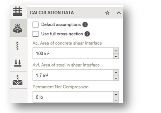

There are options for considering the use of the same or different rebar for each load type. These options are available in the Calculation Data section on the New concrete tab.
For combined moment/tension and shear loads:  There are options for considering the use of the same or different rebar for each load type. These options are available in the Calculation Data section on the New concrete tab.
When calculating the shear friction capacity, the software offers three options for defining the area of concrete (Ac) and the area of reinforcement (Avf):
  • The default assumption selection uses only the compression zone of the cross- section based on the internal moment capacity to determine Ac and Avf.
  • The full cross-section selection uses the full cross-section of the new concrete for Ac and all modeled rebar for determining the Avf.
  • The user defined option allows manual input of Ac and Avf values offering flexibility to use different rebar than what is modeled.
