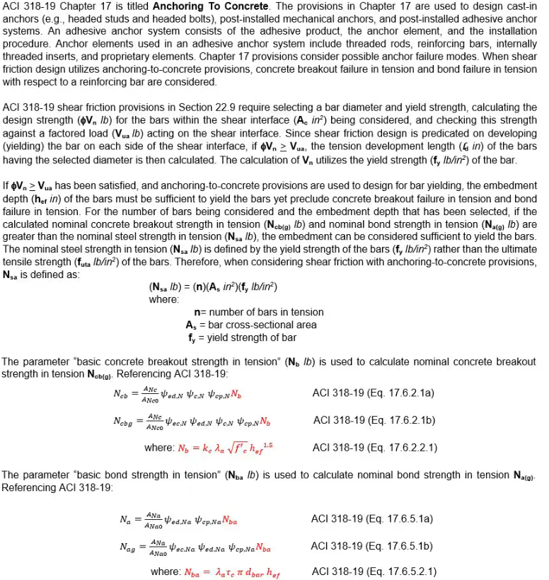

Consider a group of post-installed bars being designed for development in tension. Let the nominal steel strength be defined as (nAs)(fy), where “n” corresponds to the number of bars. If the nominal concrete breakout strength calculated for the bars (Ncb(g)) and the nominal bond strength calculated for the bars (Na(g)) are both greater than (nAs)(fy), the yield strength of the bars controls the design. By equating (Nsa lb) for a single bar, i.e., Nsa = (As)(fy), to (a) Nb calculated per Eq. (17.6.2.2.1) and (b) Nba calculated per Eq. (17.6.5.2.1), and solving for hef; an embedment depth corresponding to yielding the bar can be determined. The greater of the hef-values that have been calculated can then be used to calculate (Ncb(g) lb) and (Na(g) lb) for the number of bars (n) being developed in tension. If Ncb(g) and Na(g) calculated with this hef-value are both greater than (nAs)(fy), the embedment (hef) can be considered sufficient to yield the bars yet preclude either concrete breakout failure or bond failure. If either Ncb(g) or Na(g) calculated with the hef-value are less than (nAs)(fy), the embedment (hef) is not sufficient to preclude concrete breakout failure and bond failure. A different embedment and/or a new bar diameter and/or steel grade must be selected, and the design procedure repeated. The next section will explain the design procedure in detail.

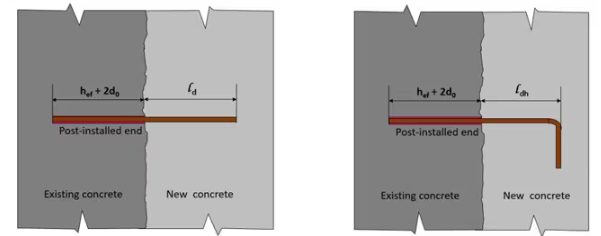

Reference the illustrations below. A post-installed reinforcing bar is designed for development on each side of a shear interface. In the context of this paper, the post-installed end can be designed for development using Chapter 17 anchoring-to-concrete provisions. Since the post-installed end of the bar is installed into existing (i.e., hardened) concrete, it must be straight. However, the bar end around which the new concrete will be placed can be straight or hooked. If the new concrete has sufficient depth, the part of the bar in the new concrete can be designed with a straight development length (ld in). Otherwise, if the new concrete depth is limited to preclude design for (ld ), the part of the bar in the new concrete can be designed with a hooked bar development length (ldh in). In the context of this paper, when a post-installed reinforcing bar is being designed for development on each side of a shear interface, the part of the bar in the existing concrete could be designed using Chapter 17 anchoring-to-concrete provisions. However, the part of the bar in the new concrete must be designed using Chapter 25 development provisions.
